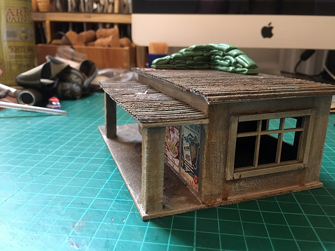

More on the hut. It doesnt mention it on the Sarissa website, but they call this model the guard hut or bicycle shed. What they dont tell you is you get a sprue of little bicycles with it. Could be useful for scatter terrain or part of a barricade or something.
Anyway, back to the hut. I’ve done some staining and weathering. A way to go yet but progress. I’ve added a corrugated tin roof and made some sandbags out of greenstuff to make the roof playable and offer some cover. I’ll need to make a ladder for it.

That’s looking great :+1: Love the sandbags, I may need to steal that idea :smiley:
I didn’t know there were bikes with it, I should really have opened the pack when I got it instead of just adding it to the pile of shame :joy:
