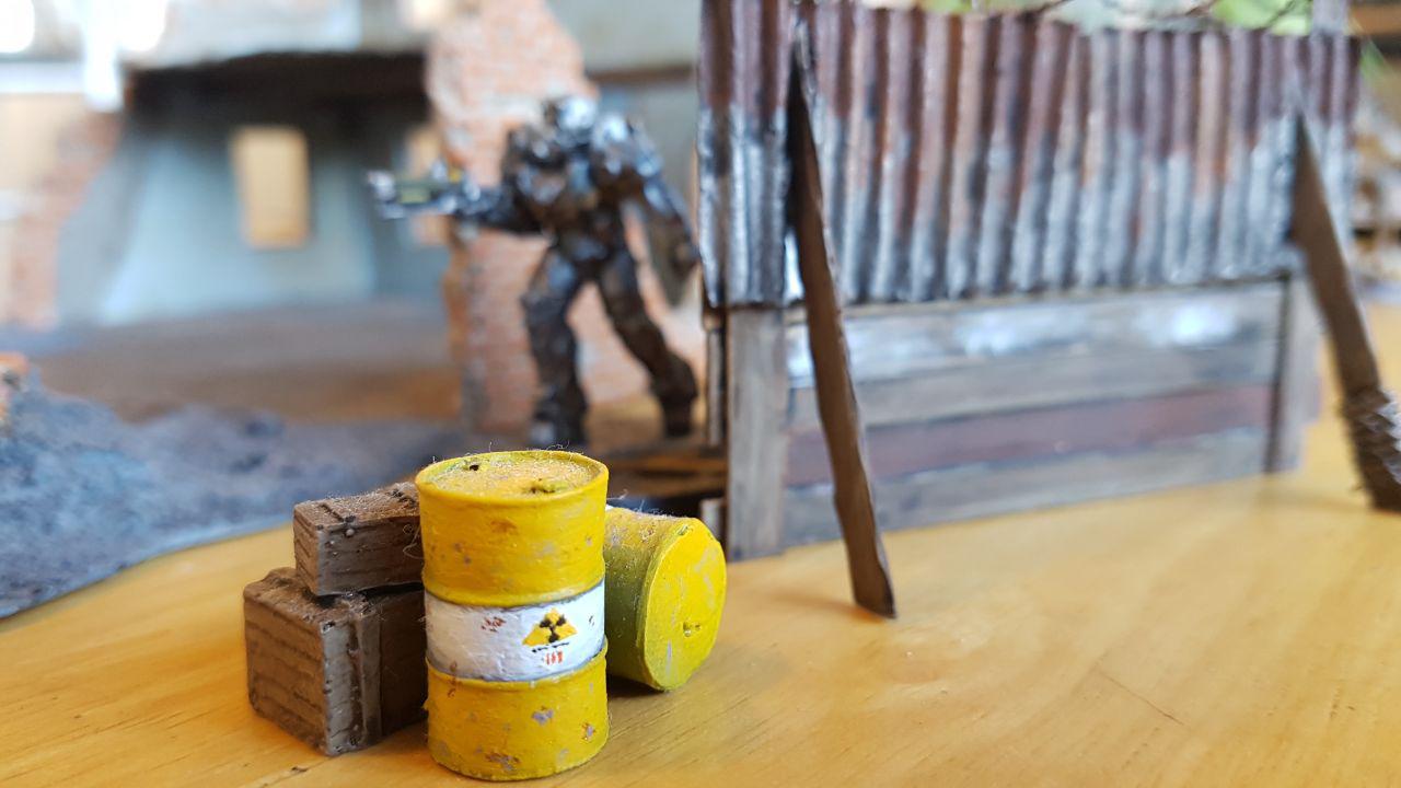

A while back I knew I was going to want some terrain to go with the wonderful miniatures Modiphius were making, but I’d never made any before and didn’t want to spend ages on something for it to turn out badly. I decided something relatively small in scope would be best, but I still wanted something big enough to spice up an otherwise bare table. With a budget of a fiver, half a pack of milliput epoxy I had laying around, and some barrels from a previous project, this is what I came up with:
If anyone has any questions (or indeed, any suggestions for improvement) on how I made it feel free to ask, it’s essentially foamboard and plasticard :slight_smile: The bricks were card by hand out of the foamboard, a technique I probably won’t employ again if I can avoid it. The carving itself wasn’t so bad, just took patience, but the paint kept soaking in whenever I tried to undercoat it and was rather frustrating. Still, I think the end result isn’t too bad for a first attempt!
The wooden barricade is made up of plasticard, cut into strips with notches taken out of it to try and make it look like old wood, and the corrugated iron is cardboard from inside an old shoebox (Supermutant for scale)
For the posters on the walls I just popped down to the library and printed off some textures that people had extracted from the game, then painted over some parts to bring out the details before fixing them on

I’ve had the same issue with paint soaking in foam board - I feel your pain!

Thanks! :slight_smile: Glad to hear I’m not the only one who’s had that issue!

Love it. Could you use a thinned down wash of PVA to seal the foamboard before painting it?

That’s not a bad idea actually, I’ll have to try it next time!

The pva wash worked well to seal my cardboard caravan before painting. I thought I might lose detail but I was pleased with the way it worked out and it took a primer coat well. I would definitely use it again to seal any porous surface.
I shouldn’t have any trouble with lost detail on foamboard, anything that I want to have much detail on I’ll use a mix of greenstuff and milliput to sculpt. I’ll definitely have to try a pva wash :slight_smile:
