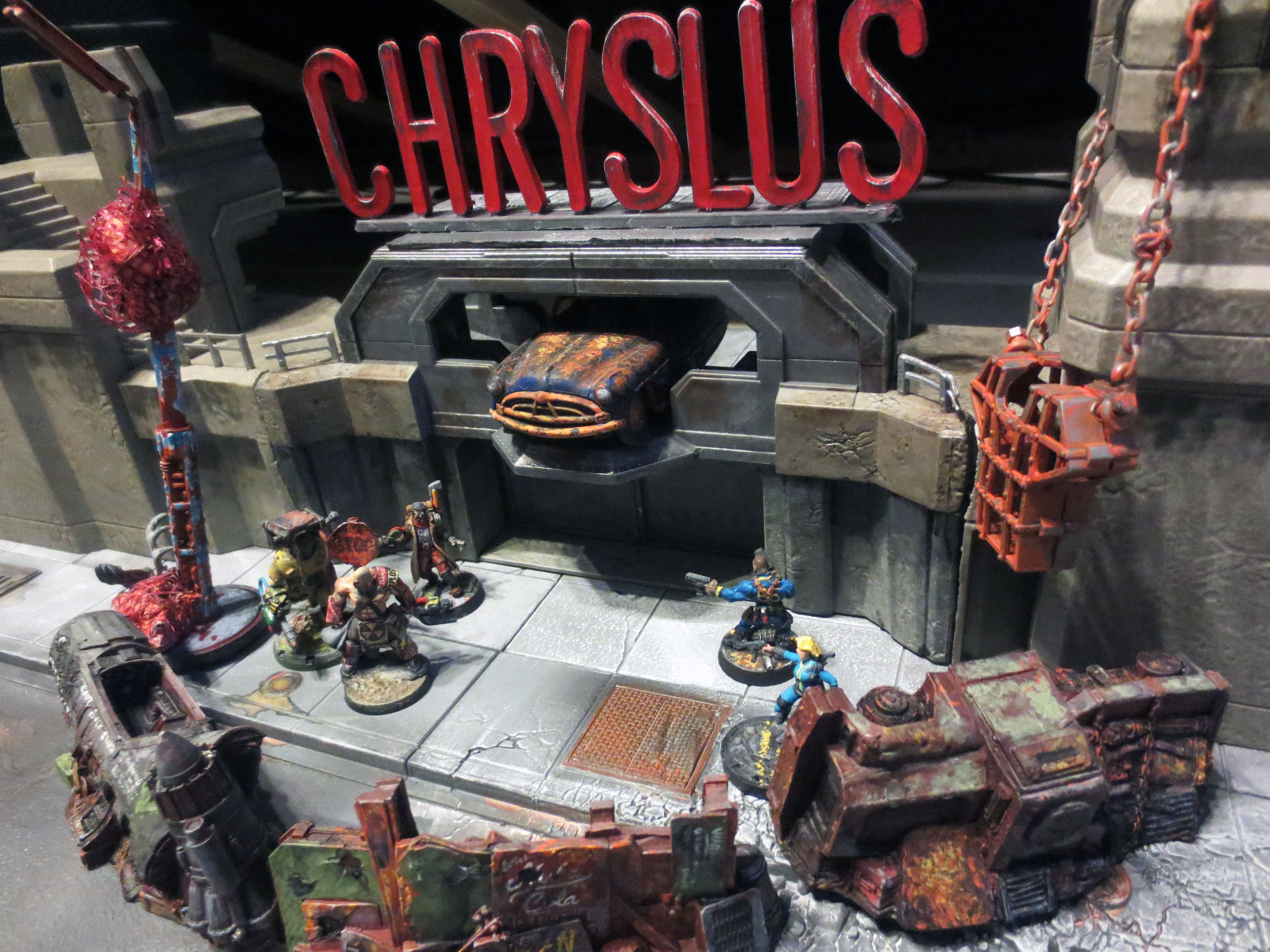

Here’s an example of a sign using the 2" high letters. I drilled holes into the bottom of each letter, and used paperclip wire to pin them down to a length of sprue that I then affixed to a section of mat board and anchored with some epoxy putty and a few decorative “Tehnolog/Robogear/Platformer” panel pieces, to set atop the gate in the picture. A nice bonus to the letters is that if any of them fall off … well, it’s a post-apocalyptic wasteland! That only makes it look more authentic. :slight_smile:

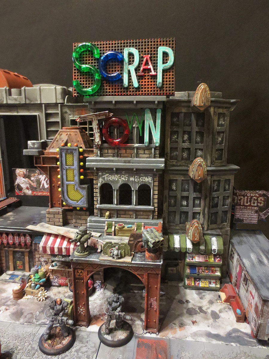

Here’s another application: deliberate MISMATCHING of letter styles for a “scavenged” look. This is a facade meant to represent an off-board settlement (and entrance thereto), built out of a GeoTax “Big City Lights” partial playset I picked up at a thrift store. For the general look, I was inspired by “scavenged”-looking signs from Fallout: New Vegas – starting with the “PROSPECTOR SALOON” sign in Goodsprings.
The large light blue letters are 2"-high letterboard letters; the red “A” is a 1"-high letterboard letter.
The “T” is a Warhammer 40K “tank trap” scatter terrain piece – originally an “X” shape, but I cut off one prong and reattached it on the opposite side to make a “T” and then used some clear plastic sprue to make “light bars” to place on top of the painted rusty “T.”
The “W” is cut out from a translucent green plastic small “bin” or “basket” that I got some strawberries in a long time ago; it just happened to have a curvy grid pattern that I was able to identify a “W” that I could cut out of it.
The “S” and “C” and “O” are made from some “tangle toy” pieces (a string of macaroni-shaped plastic sections that pop together end to end – unless, of course, someone breaks off the little plastic plug).
