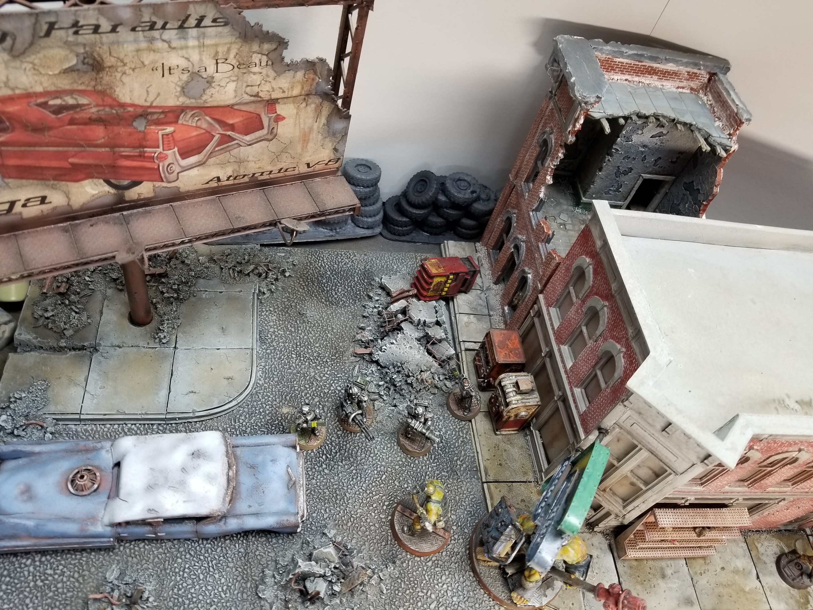

Back in the Fallout 3 / New Vegas era, I didnt have a ruleset, or many options for Miniatures, but I built some Fallout Terrain, mostly from in-game screenshots. I like to use plastic. It’s my favorite medium. If you have any questions, feel free to ask.

The soda machines look awesome. You said you had made them from scratch? It’s clear you put a lot of love into them. Here’s hoping Midiphius does a Sunset Sarsaparilla machine as well as the Nuka Cola machine style from the earlier games. Would make a great little bit of terrain for the table.
Love your posters and billboards. I’m guessing you just printed the images and aged them somehow? I’m actually planning to print mine up, dip them in coffee, then sit them on something flat and tip them on end so I get the aged streaking look. How did you accomplish the tearing of the page? Just get it wet and let it dry on something before pealing it off? Or did you do something else?
The store sign looks really good. And the cans on the shelf are a really great touch.
And that’s not to mention the buildings that look perfect.
Really love seeing all your hard work, looks like you’ve got terrain to create a really top notch table.

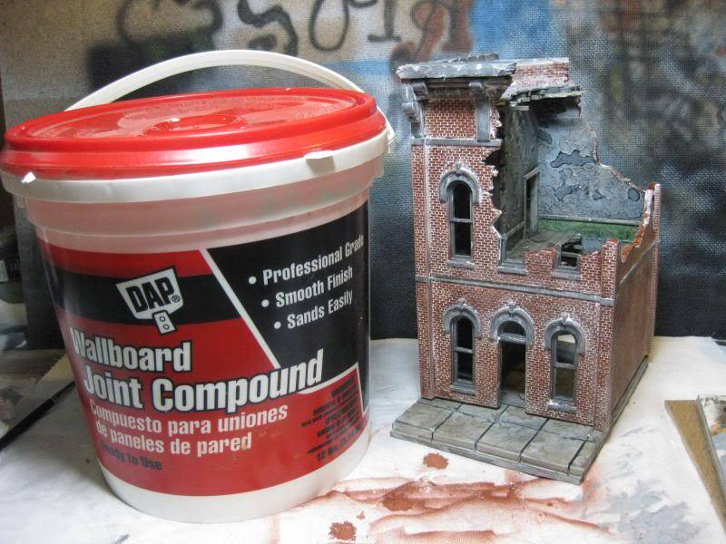

Would you mind telling us how you did the brick patterns? On my first (and so far only) attempt I inscribed the pattern manually into foamboard, was thinking about using patterned styrene sheet instead for future projects. Whatever method you used looks amazing though!

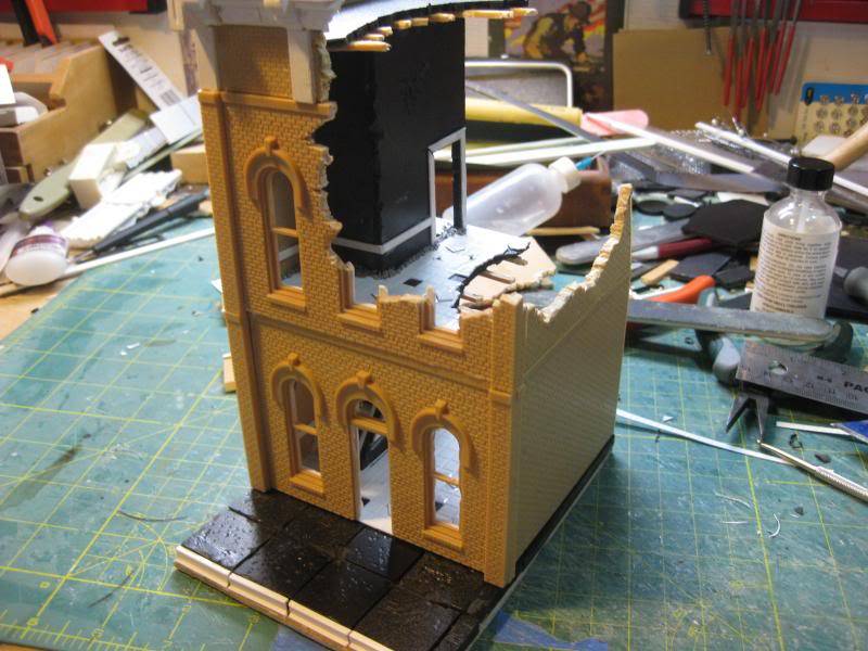

@ Alaiteir - The Walls are Resin Wall panels from an O Gauge Railroad company called Design Preservation Models. They are not easy to work with. I had to grind the corner pieces at 45 degrees with a belt sander. But they are as sturdy as rock once glued together.
If your question was how I got that white mortar look, it’s because it’s essentially REAL mortar.
I use regular Drywall Mud
When you open the can, the water that seperates from the mix sits on top, use this pre-thinned milky mix.
Dip and rub it into the bricks
Rub it off with a clean, wet, cloth
Rub it off with a clean, dry cloth

I wish I had half that talent. The soda machines are really beautiful. Really nice to see the unpainted versions too, it emphasizes just how much work you put into them to make them look the way they do.

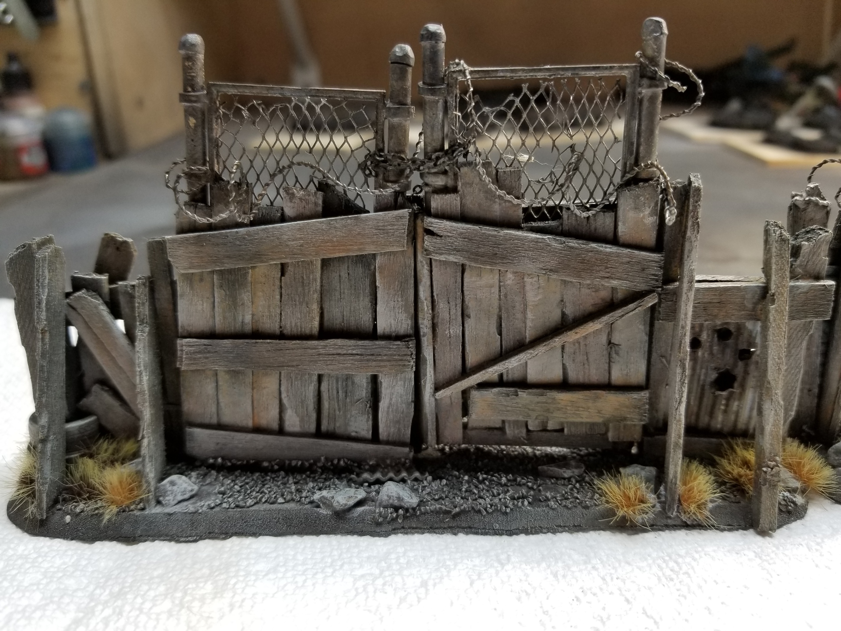

As for your terrain, how’d you get the colors the way you did? It looks absolutely fantastic! Real top notch stuff and you accomplished an amazing aged wood look.
Thanks Gate!
I love painting weathered wood. I started with a black primer, then I painted individual boards with thinned Vallejo Wood, Minitaire Bark for the basecoats. Then I applied washes, light to dark, allowing them to dry OR immediately spraying them down with water to diffuse the color patterns. Vallejo Grey, Vallejo Brown, Vallejo Oiled Earth (same as GW Nuln oil), Vallejo Black. Then Highlight individual boards with their base colors again across the grain (being messy, not covering but 30% of the boards - makes patterns) Then, to add the old grey look to the boards, I slopped on thinned Minitaire Dusty Ground, and then Drybrush and edge highlights with the Two Swiss Army Paints Vallejo Deck Tan and Vallejo Ivory, and a 50/50 mix of the two between. Then I washed with Vallejo brown in spots again and plain water in spots again to diffuse the highlight a bit.
