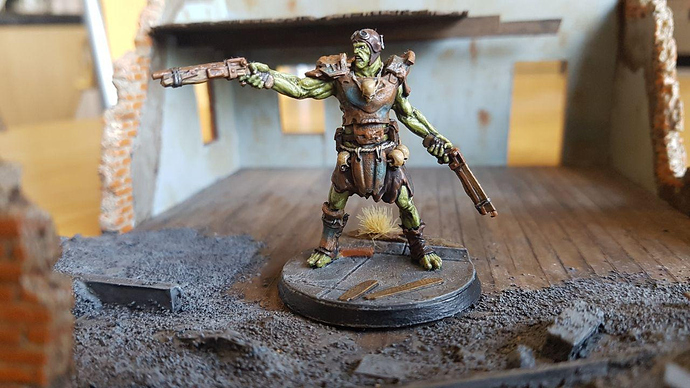

It varies a little from model to model, depending on how rusty I want it. On my raiders I started with a layer of metal colour (Leadbelcher), but on my supermutants I just went straight for a rich dark brown (Mournfang Brown). I gave these a brown wash (Agrax Earthshade), then stippled some lighter browns (Skrag Brown) with a little orange (Fire Dragon Bright) mixed in for some spots. I then finished with some small chips done in a bright metal/silver colour. On my supermutants I then also applied a few small patches of greenish blue colours for a kind of oxidised/verdigris look :slight_smile:
