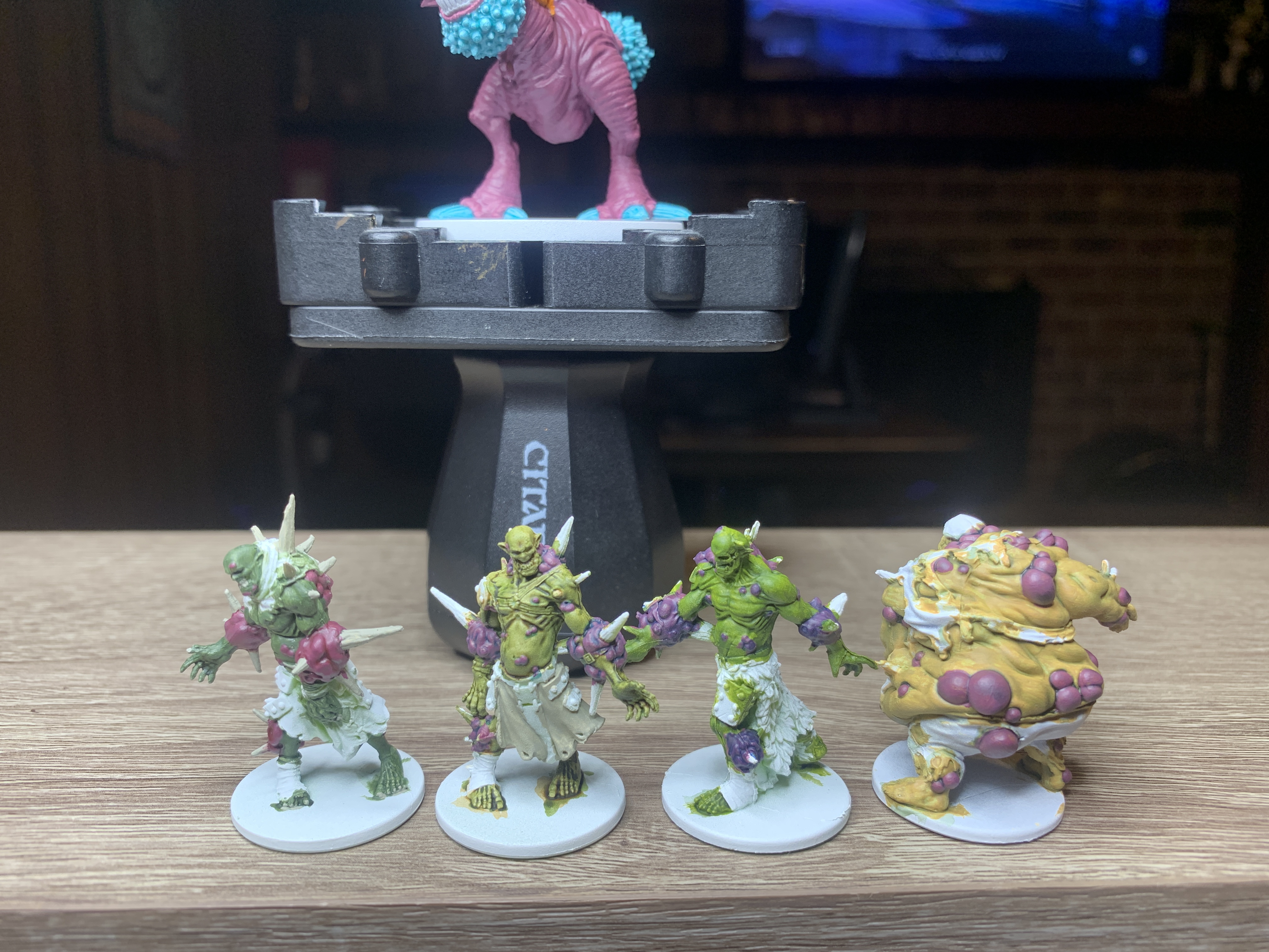

The one with the spiky zombies:
Various combos of either straight contrast (same green as all the others) or using the contrast as a wash over a “standard” green paint.
