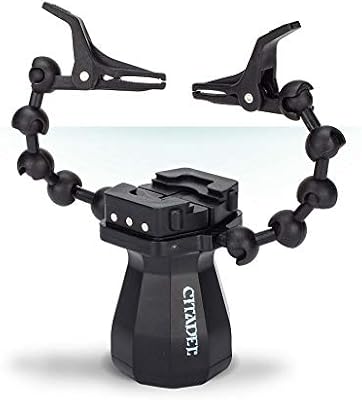

As for putting models together, two things that I’ll sear by: The first, Gel style superglue. It helps to keep it where you need it and cuts down on mess just a little bit. It also will hold smaller pieces in place without as much need to hold it as long. The second is an assembly handle, which is arguably one of the best purchases I’ve ever made for the hobby. It can be used to hold pieces in place while they dry which is VERY nice, but they also are good for painting as they give you a bit more control over how and where to paint.

Totally agree with regards to an assembly handle, great investment and a really useful piece of kit, especially if you suffer from occasional shakes.
