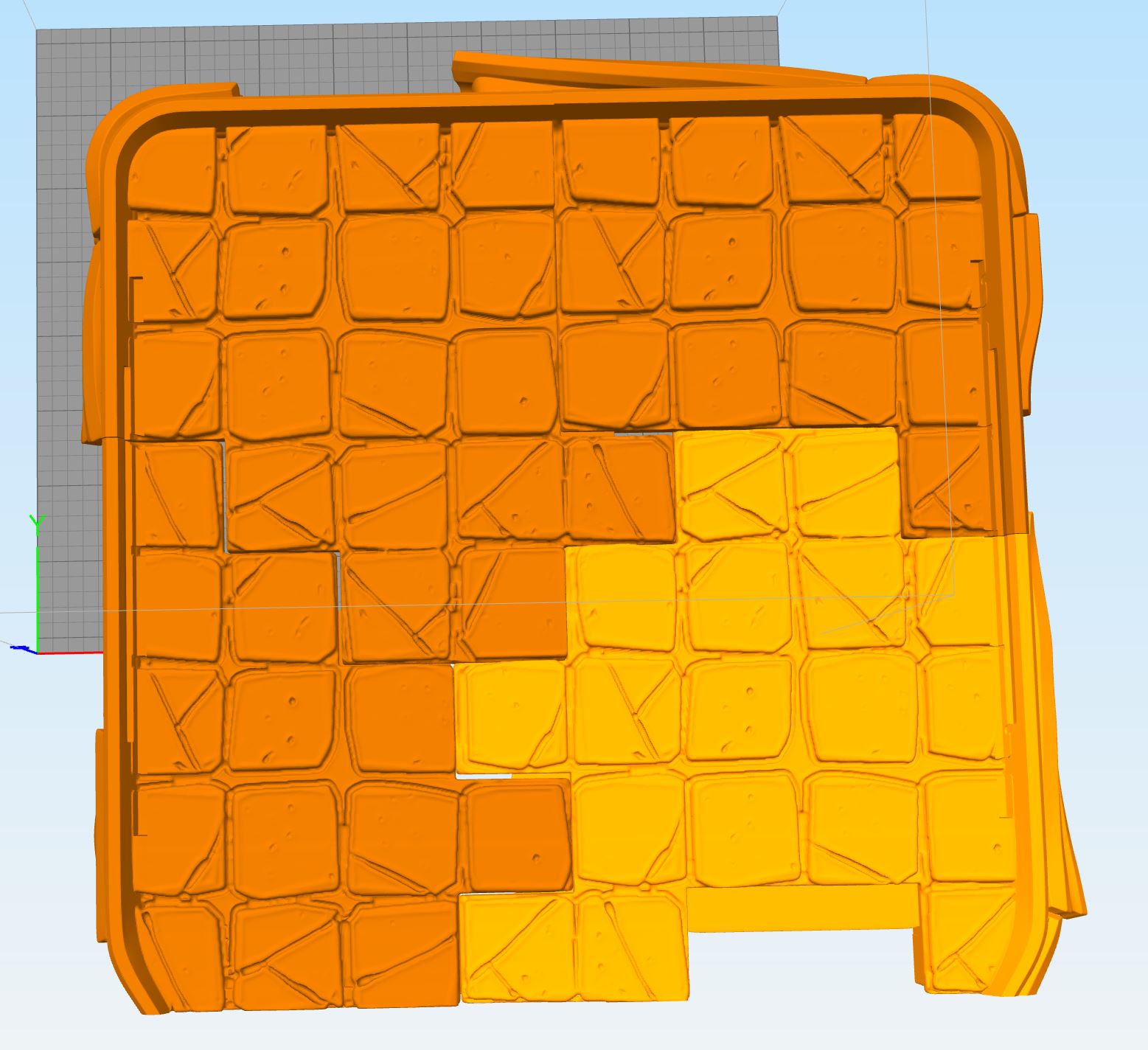

Smoothing or filling layer lines isn’t worth the effort when I can just print it in resin and avoid all that. I bought my Mighty 4k specifically for bigger prints like this. Fortunately I was able to get the resin prints to come out nice with a little more work. However the problem I’m having now is the model itself. It looks like they designed the roof pieces independently instead of doing the whole roof and cutting it up into pieces. Even when I put it into my slicer and assemble the parts they don’t properly line up and there are gaps. So either way I’m going to be filling gaps. My 2 awning pieces came out nice so I will probably re-do the roof pieces with the added supports too…still will have a lot of gaps to fill but it will be less and will fit together better.
